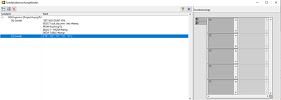

i try to select values from my database.
My problem is, i do not get all values from a few tables.

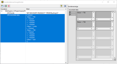

If i Put "SET NOCOUNT ON;" i get the same results as before

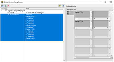

Your Query DOES return data, if you look at the probe.
The result has two rows and six columns, from which only the first and last contain data:
| 702 |   |   |   |   |  costa |
| 704 |   |   |   |   |  asd   |
What do you get when you run the query with an other database client? Are those fields NULL ?

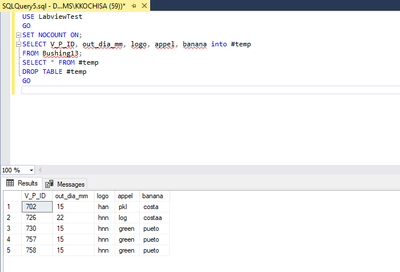

i've tried the same query in managament studio - i get all values. Just in Labview i do not get all values

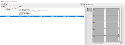

here are the results 
I do not get the same reslults by the same query.
if i replace the "NO COUNT ON " with "SET NOCOUNT OFF"  i get an error message
I also tried to select the values just per coulmn and then i get the missing values
this shows one of the missing columns
