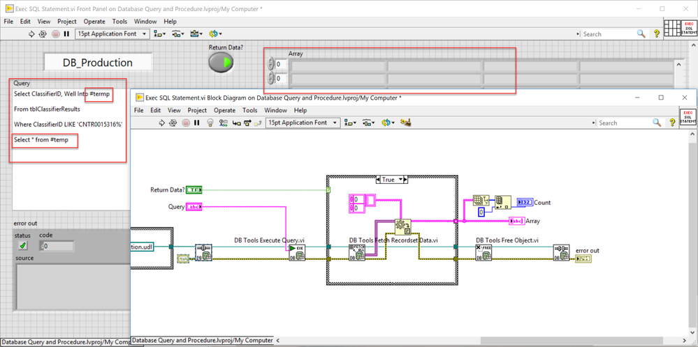

The following SQL query is a simplified test to use a temporary table.
  • Select ClassifierID, Well Into #temp
  • From tblClassifierResults
  • Where ClassifierID LIKE 'CNTR0015316%'
  • Select * from #temp
When I ran this query from the 'SQL management studio', I could get the correct results.
However when I ran it in LabView, no results were returned.

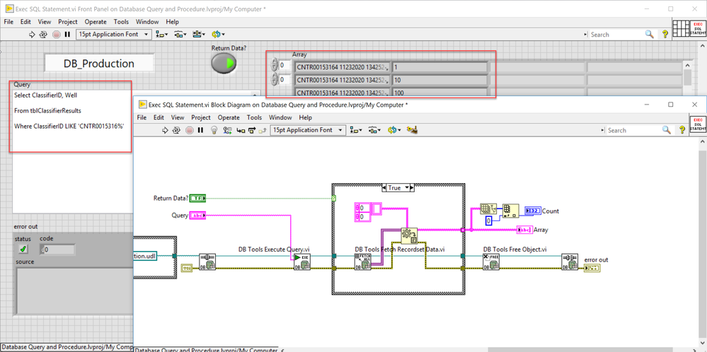

If I took the temporary table out of the query, it worked fine in LabView.

Spelling error?  Was there an error message?
In your pictures you have.. "Select .. into #termp" then "Select * from #temp".
Both valid statements, but not likely to work as intended.

Thanks for pointing the spelling error out. It is absolutely a spelling error.
I corrected the spelling error and ran the query again. It runs without any error, but does not return any data. Feels to me that this is a LabView database toolkit issue.

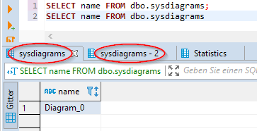

If you execute two SELECTs in a single query, you will get two results, each followed by some statistics about the query, which also mark the end of the current result.
See for example this screenshot from my DB client  "DBeaver" :
2020-12-02 09_03_46-DBeaver 7.1.4 - __localhost_ Script-128.png2020-12-02 09_03_46-DBeaver 7.1.4 - __localhost_ Script-128.png
(OK, this is boring, two times the same query and the same result, but yet, two results)
The point is, when the first query does not return anything, there is still an empty result plus statistics sent back to the client.
Most clients suppress empty results automatically, and only display non-empty results.
Labview... does not. Instead, it stops reading the result when it recognizes the first statistics information.

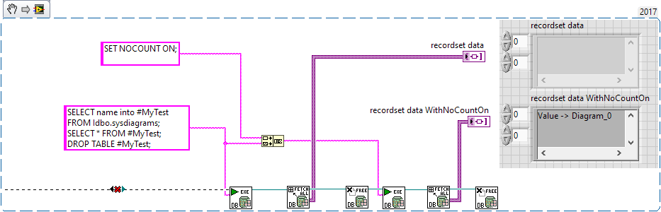

The solution is to disable those statistics by sending SET NOCOUNT ON; at the beginning of the query:
Message 5 of 11
