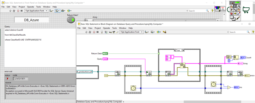

We have a data table that is growing every day, roughly 40M records as of today.
it causes some of queries to run slower and slower.
One of the query is as follows
     select distinct ScanID
     from tblClassifierResults
     where ClassifierID LIKE 'CNTR%04052021%'
'ClassifierID' is the primary key of the table, so there is an automatic index for it.
When I ran the same query in 'Azure Data Studio', it took long time to run as well, but it does not time out. I can get data after the query is complete.
But when I ran it in LabView, I got the following error.
NI_Database_API.lvlib:Conn Execute.vi->Exec SQL Statement.vi<ERR>ADO Error: 0x80040E31
Exception occured in Microsoft OLE DB Provider for SQL Server: Query timeout expired in NI_Database_API.lvlib:Conn Execute.vi->Exec SQL Statement.vi
I don't feel that this is a LabView issue. All LV does is to send the query and wait for any response.
On the other hand, the default time out in the Azure is like 600 seconds, long enough to complete the query.
My question is why LabView gets a time-out error here? Any solution to let LV wait a bit longer until the query is complete?

Default connection timeout is 15 seconds (in the Open Connection VI), and you don't have anything wired there so that's the timeout you're using currently. Try wiring a higher number to that timeout terminal.

The short answer to your question is, specify a longer command timeout, which is a property at the Connection level.  There is a polymorphic VI DB Tools Set Properties in the Connectivity>Database>Utility subpalette which, when wired at the Connection refnum level, allows you to set a timeout for all commands (in integer seconds).

I think that timeout (for Open Connection) is only for the open action itself.  I'm unsure it carries over automatically to all subsequent transactions (I could be wrong).  I think the set properties method I described is the only way to be sure.

David,
You are correct. The timeout in the connection VI does not apply to the subsequent transaction time.
I did your way and it worked.
