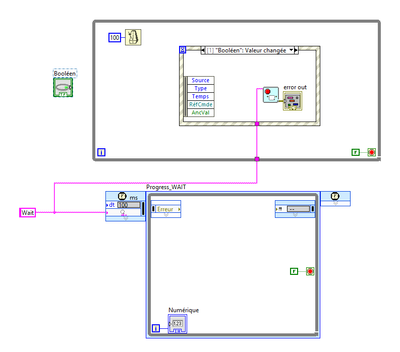

Hello!
I made a very simple test vi to verify that the stop function of a Timed Loop works correctly. To my surprise, it doesn't work at all! The national instrument example does not work any more! I'm on a recent PC under W10...
What's wrong in my code ?
The error message is (in french, sorry) :
LabVIEW: (Hex 0xFFFFFCDC) La structure cadencée n'existe pas ; il se peut qu'elle n'ait jamais été créée, qu'elle ait été supprimée ou qu'une action illégale ait été tentée.
Error code -804
Thank you  for the help !

How are you going to see a value change event on your boolean control unless you READ it!  Stick the terminal in the Value Change Event case or at least inside the event loop somewhere!

I reproduced his code to see if that affected the issue.  It didn't, but of course the control didn't work properly and stayed latched.  Then I tried putting the whole button loop and event code into a disable structure and I still got the same error the OP mentioned about no timed loop found.  I made a mistake and connected the loop Source Name instead of the Structure Name, which is an easy mistake since it's the one visible when you drop down a Timed Loop.  It's possible OP made the same mistake and the wire is bent under the Input Node, but no telling with just an image.
In any case, he said it's working in LabVIEW now, just not in TestStand so maybe all the timed loop features aren't supported in TestStand, or there is a real bug.  I don't use TestStand, and although I thought the timed loop was a really cool addition to LabVIEW, I've never found a use case that actually required it.  It wouldn't surprise me at all if there were still issues under the hood.
EDIT: BTW, if you want to see the error just put down a Timed Loop and wire any string to the Source Name input.  Loop won't run and throws an error.
EDIT2: LV Help explains that you need create a timing source, so I guess you have to set that up before you use the input.

"How are you going to see a value change event on your boolean control unless you READ it!  Stick the terminal in the Value Change Event case or at least inside the event loop somewhere!"
I didn't understand. The boolean is read by the event structure. I've always done it that way. as soon as the event is triggered (in this case as soon as the button changes state) we go to the event structure on the case concerned and the code is executed (in this case the timed loop is stopped) no ?
