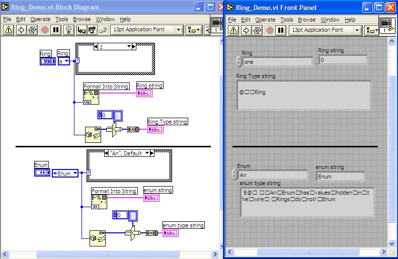

Tough one Paul... it made me think for awile.  As for most eloquently without adding many unneeded function calls I dont think there is, currently, a good work around.  I agree a built in string table with lookup would be useful.  For ease of programming I still prefer typedef'd enums and just access the strings associated with the items.  What helps me in some cases is to make the conversion in a SubVI using a copy of the typedef'd enum with reference.  Perhaps it would suit your needs also.  See picture for what I mean.  It has all the advantages of making constants and picking the item you want plus being able to change the enum and having the changes propigate throughout the code...

Type def'd enums combined with the "format Into String" function should do the trick.

Pfff, Format into String takes an enum?
Learn something new everyday.  I agree thats much better.  New and improved Smiley Very Happy.  And to think all this time i've been using old and inferior.  Thanks for sharing!  Nice trick.
