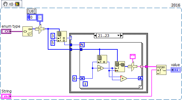

Hi Billko,
             The setup you showed only displayed the only the number corresponding to the first 2 characters of the string. The rest of the string did not have any effect. Is it supposed to work this way?
Thanks.
Vincent

Hi SSHADOR!
The tables on the snapshots are array constants. You can create in the diagram block (rigth click > Array > Array constant). Then you put inside a numeric constant (blue table) and string constant (pink table).

Hi Paul,
            The figure you gave only displays one character at  a time.
Vince

Hi Jimbe,
              Please see the attach. It did not work for me. I am confused now.
It does not work for any of us, because it is just a picture. We cannot run a picture.
Please attach the actual VI instead.
(event structures belong inside a while loop and not vice versa. You were told to use a FOR loop because the number of iterations is known before the loop starts. You string does not have any spaces, so why does your format have them? ...?)
Message 16 of 17
(1,697 Views)
@SSHADOR wrote:
Hi Jimbe,
Your Scan from string looks for 2 characters and then a space. Unless you write your number as lu su ke it won't work.
/Y
