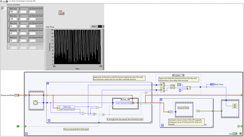

If you aren't using XNet then there are several software timed options.  Here is one solution I made up which keeps track of when each frame has been sent last, and will then figure out how long is the minimum wait time it should wait until the next transmission.  I put in a disabled diagram structure which just adds a wait of 1ms between loops but I think this is a better solution if it works.
