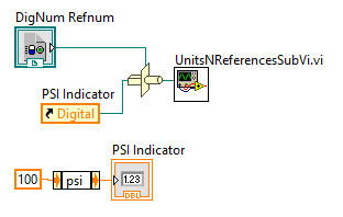

In my example VI I have an indicator with a unit label of psi. I set this indicator to 100. I then create a reference and try to pass it into my subVI.

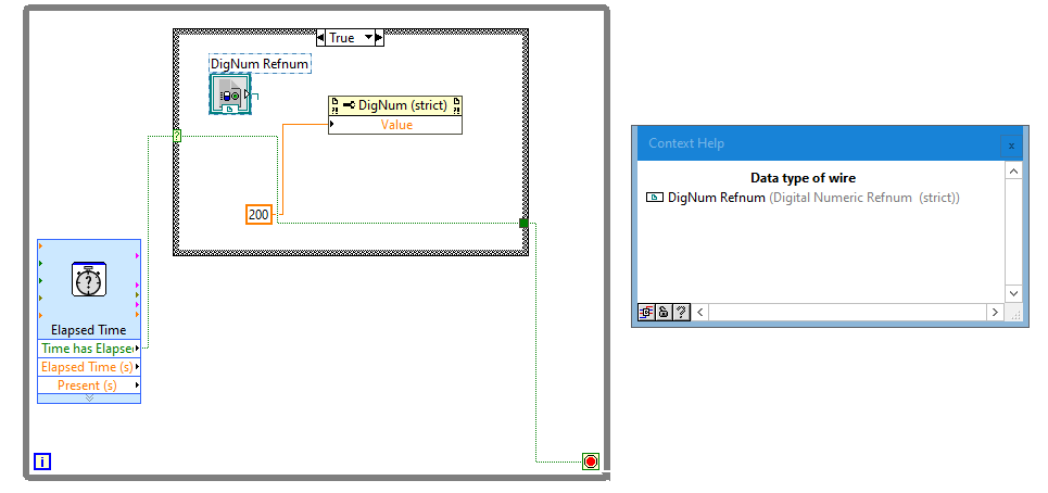

Here is the subVI as well:

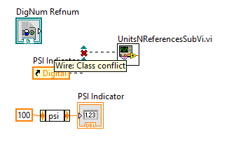

With this first attempt I get a class conflict on the wire, which I'm not sure how that is the case as both the reference and the input object of the subVI are DigNum Refnum (strict) types. (Note: the wire is connected to the property node in my subVI the screenshot just didn't capture it for some reason)
So I thought lets go ahead and type cast the input before we pass it to the SubVI, which works:
However, my VI correctly shows 100 psi on startup on the indicator, but after the 5 second delay of the subVI, 200 is inputted into the value property node, and this shows on the indicator on the main.vi:
If I try to put a unit convertor on the wire between the 200 constant and the value property node I get an error, as the property value node says it has no Units, even though the object I'm referencing does. There seems to be some kind of conversion somewhere along the way with this process that isn't properly displaying the 200 psi I'm trying to get to.

Paul,
You don't happen to have any insight on the reason why a Type Casting was necessary in this case? It would seem to me that the object's reference and the input typing in the SubVI were the same but I'm missing something apparently as the Type Casting was necessary for this example to work.

@darrenlwoodson wrote:
Paul,
Although the wires look the same, numbers with units are a different data type than numbers without units.  Moreover, each physical quantity is a different data type (e.g a number with length units is a different data type than a number with time units).
