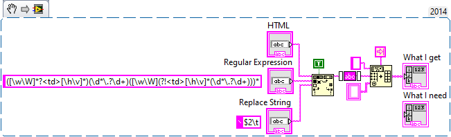

I have a problem with parsing some HTML code (table). I'm not too good with regular expression and I need help.

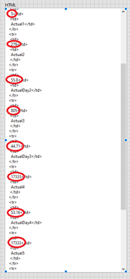

The HTML code is in vi. How to get marked ones in array using regexp?
Ty!

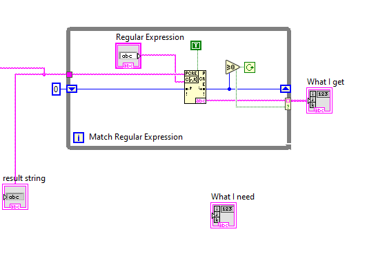

There are hundreds of expressions that will match a result...
Something like this: "(?m)<td>\s*([0-9]+\.[0-9]+)". Then use the first capturing group.
No expression will give an array. You'd have to loop until the index is -1. Put the index in a shift register, and use it for the next iteration. Don't add the last element, or delete it.
EDIT: Use "(?m)<td>\s*([0-9]+\.?[0-9]*)". Or (?m)<td>\s*(\d[^<\s]+)

That was it, thank you. I guess I shoud improve my regexp skill 😐
