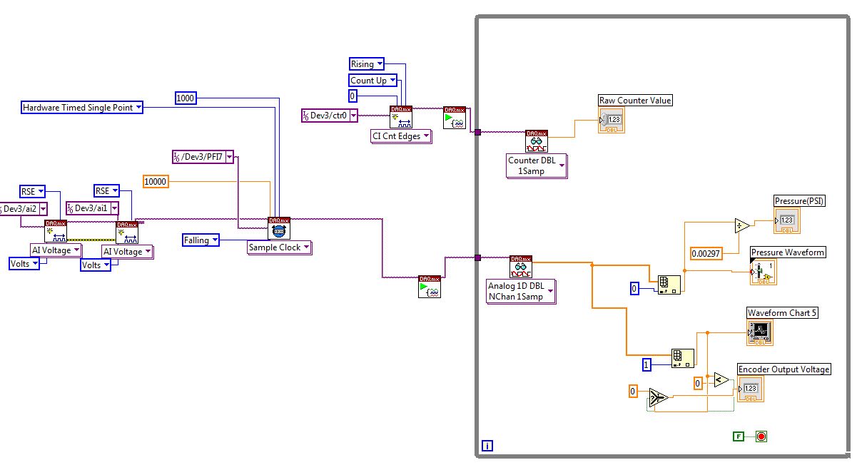

I am trying to sample voltages while using the rotary encoder as my sample clock. Every time the encoder rotates a degree it outputs a signal and I'm using that signal to sample values at that instant.
I keep getting Error -201319:
Possible reason(s):
Sample Clock pulse occurred before the previous sample was acquired from all channels in the task. Use a Sample Clock rate that allows time for the device to acquire samples from all channels. If you are using an external Sample Clock, ensure that clock signal is within the jitter and voltage level specifications and without glitches.
My program is shown below:

Hi Jeff,
I am acquiring a pressure signal from an internal combustion engine timing by an external clock (encoder), code starts to acquire but after a moment this stops and show two error types 201319 or 200019. Hardware is PCIe-6351 for data acquisition.
