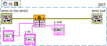

and here is the corresponding labview diagram :
the parameters of the library call are both set to string, string handle.
