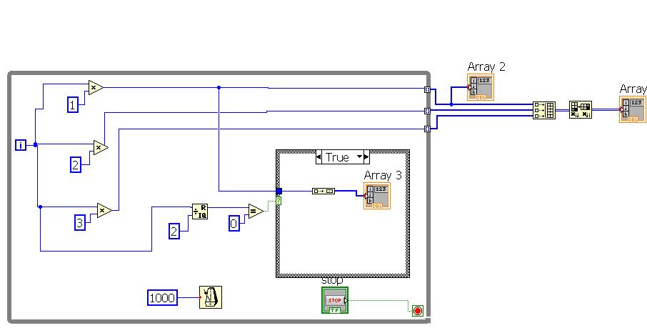

See this figure:
1) I desire to save an array with ONLY same data that are taken only if there is a particular condition like the figure (Array3). I have done this, but doesn't save array, but only the last number. Can You do this VI to save an array when the condition of CASE LOOP it's true?
2) Il the right part of VI I desire save an array (better MAtrix Array), but I desire only an array of 30 element. After 30 elements I desire to start again from index 0. Can I do this? And after I desire to show in control panel the data of particular index (for example the 3 value of the same index of the maximun of the second column). Can I do this?
3) To finish I desire save array of 30 elements in an excel file.
Can You repeat a VI in LW8 for me please with this corrections? Thanks.

For array three try making the build array block so it has 2 inputs, put the data you want to add into the second input, and put the output of the block as feedback into the first input.

can you do whit features of question 1, 2 and 3? Maybe ut's simple to understand.
