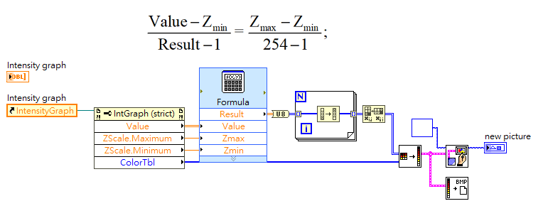

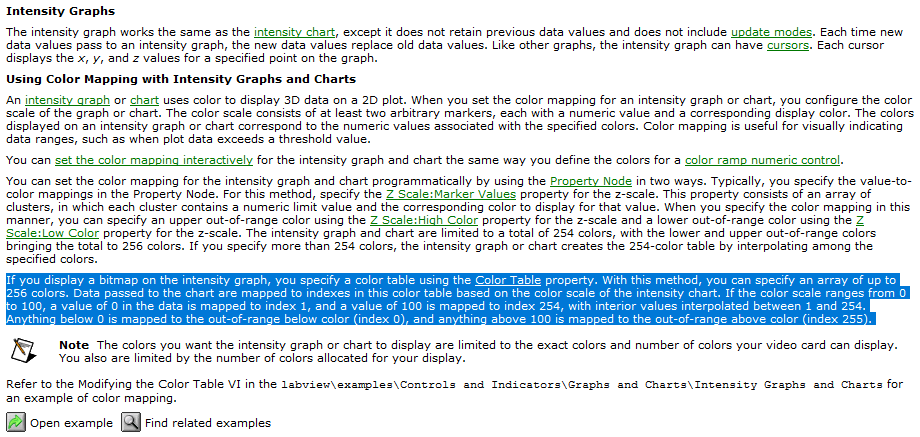

I also met the same problem today but finally solved it.
The idea comes from the LabVIEW context help
Hope this could help someone...
Message 10 of 10
