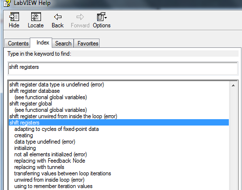

Hi Emanuele,
The three-hour course will cover most of the basics, which includes shift registers.  In the meantime, there's always that terrific resource, the LabVIEW help files:
That's always a good place to start.  You can learn about all kinds of things there, as I have mentioned previously.  Smiley Happy
