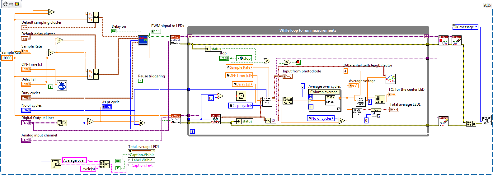

I got this system handed over to me. I'm new to LabView and simply need to save the data that comes from array "Average Voltage"(Inside the while loop) to do some further test of our product.
I'll like it to do similar to this.
1) Save in excel file.
2) Save only when a buttom is pressed and save the next 5 ilteration.
3) Save and manipulate the data, so it is shown in 6 colums(1 from each LED) instead of 1 long colum.
I tried different things with T/F case structure, that solved the buttom-demand. But I'm in doubt of which I should use, Write To Measurement file or Write to Delimited Spreadsheet (Using labview 15.0) to suit my propose best possible?
It also seems to be to much to handle when i try write to txt file, because it pops up with and error that I dont know how to fix, but it is telling this:
Error -200279 occurred
Possible reason(s):
The application is not able to keep up with the hardware acquisition.
Increasing the buffer size, reading the data more frequently, or specifying a fixed number of samples to read instead of reading all available samples might correct the problem.
Property: RelativeTo
Corresponding Value: Current Read Position
Property: Offset
Corresponding Value: 0
Task Name: Analog channel
Message 1 of 17
(9,717 Views)

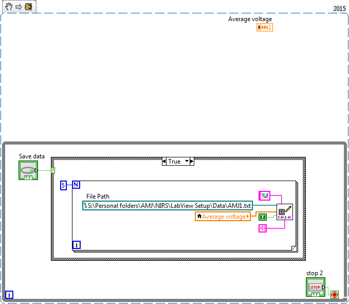

Okey, I hear what you say and tried with the TDMS file but end up doing this. It works okey except that I cannot run the program while having the txt file open. This is not essensital but could be nice 🙂
But what I end up doing is:
It writes my data in the txt file as shown in following document. I also shown what my wanted scenario could look like. What can I do to make it look like the example below?
Scenario at the moment
2,973682 2,973655 2,973651 2,973735 2,973671 2,973716   These are from 1. measurement
2,973819 2,973866 2,97383 2,973856 2,973832 2,973725   These are from 1. measurement
2,973746 2,973829 2,973832 2,973806 2,973856 2,973846   These are from 1. measurement
2,973632 2,973656 2,973697 2,97359 2,973703 2,97364   These are from 2. measurement
2,973685 2,973792 2,973833 2,973761 2,97354 2,973701   These are from 2. measurement
2,973767 2,973743 2,973825 2,973679 2,973746 2,973754   These are from 2. measurement

Okey thanks.
I'll try include the TMDS file instead. But as i have my data in an array. Can i just wire the my data from my array into the Write to Measurement(TMDS) function?
The TMDS is supposed to be created by the Write to Measurement function, right? Or i'm supposed to use those function under file I/0 --> TMD Streaming?
