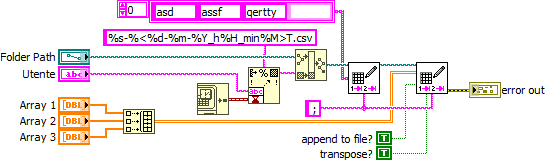

i'm uploading an image of what I have done; I think there are many errors
You know we cannot edit/debug/run images in LabVIEW, don't you?
Why do you "think" there might be errors? Why don't you know?
Why don't you debug your VI to find those errors (if they exist)…

ok if you want, i upload the VI. Is my firt time with saving data and  i try to use my vi but it give me error n.7 i dont know solve it.

Hi John,
Which filepath do you use?
As soon as I use valid values for path and "Utente" your VI works without errors…
You forgot to add controls for your other needed data (username, etc.).
But with your VI you know how to
  • create a CSV file
  • write a row of headers
  • write/append a 2D array of value
Now you just need to append some more data! (And implementing error handling would help, too.)

  • Your path needs to be an existing folder, so make sure to adjust the browse option accordingly.
  • Your "Utente" control should be set to "limit to single line"
  • You don't need to wire a timestamp to "format date/time" because the default is the current time
  • It seems easier to do everything at once using "format into string"
  • You need to transpose your 2D array to get three columns (or set transpose=true in the file IO)
  • Why have all these scattered scalar strings instead of a string array diagram constant?
  • Why is the front panel such a mess?
Here's one possible cleaned up version (I probably would make the time format a bit nicer, though).
