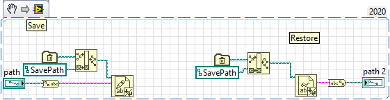

No need to go down the INI file rabbit hole when a simple one line text file containing the path will work.

@RTSLVU,
Thanks for replying. Can you attach the VI file of screenshot?
what block diagarm blocks it have?
Message 7 of 8
(2,825 Views)
Hi Vindhy,
RTSLVU attached a snippet - look for "snippets" in the LabVIEW help!
(And all those functions are found in the file functions palette…)
