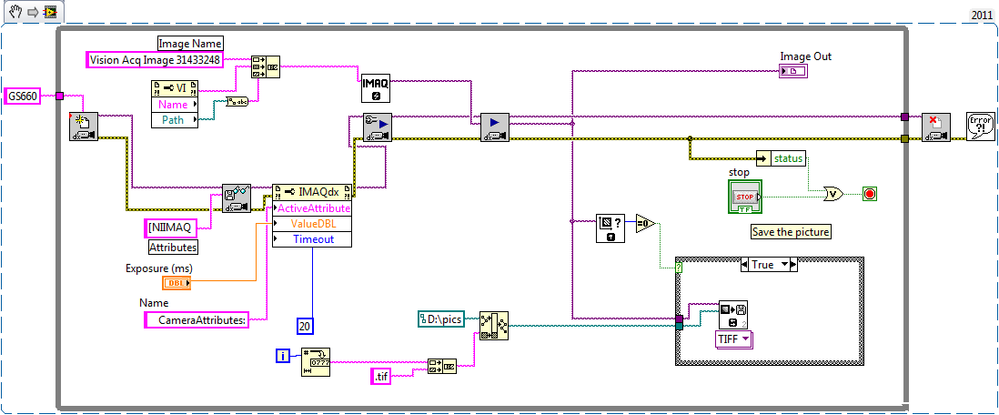

I have setup a GigE camera in a while loop.
The camera waits for an external TTL signal (there is a built-in hardware trigger receiver) and each time there is a TTL signal I can see the different image in the Vision-->Image Display indicator on the front end of my program.
I would like to save those images as they come from the camera (just as they are displayed on the Image Indicator) but every time I try to do this , many images are saved on disk (apparently the same one each time with different name) plus even when the TTL signal is off the images keep being saved on disk.
What I would like to do is a way to save the images that appear on the Vision-->Image DIsplay indicator in real time and stop when there is no TTL signal present.

Hi Yannis,
From what I understand you are having no problems with getting the different frames to appear on the "Image Out" indicator whenever you generate a TTL signal but you are having problems with saving the different images as and when they are captured.
However based on your code, you are only ever displaying one image whenever you run the application and this same image is displayed on the "Image Out" indicator of your Front Panel.  This would then mean that you save the same image to file over and over again.  The reasons for this behaviour are as follows:
  • The First Call? function wired to the first case structure at the start of your program means that the code within that structure will only ever run once, since this function will only output a "true" value when the code is first run.  I would suggest removing this function as well as the outer case structure.  Right click on the case structure and select "Remove Case Structure".
  • Furthermore, the true constant wired to the conditional terminal of the inner while loop means that the loop will only ever iterate once and therefore only ever acquire one image to pass on.  You can remove this while loop to ensure you are continuously acquiring images from the camera.

Can I also confirm whether or not you are expecting the Y Resolution output from the IMAQ GetImage Size function to always output a value of 0?  If so, there is no need for this function to be in your code and the image will be saved to file as and when it is acquired.
On a side note, if you are using error cluster wires, make sure you include an error handler within your code (normally placed at the end) so that any errors are reported once your code has finished executing.
