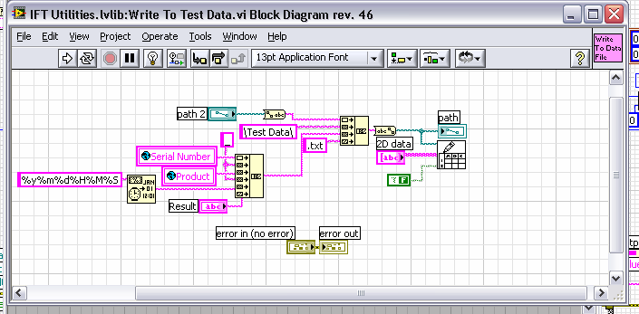

Save "Build table"
     I have to save the data of a table in a file, to obtain the table, I`m using the function "Buid Table", but when I try to save with the function "write file", this create the file, but when I open the file, is empty.  I was trying with another functions like "write to spreadsheet file", "write characters to file", ""write to I16file", or "write to SGL file", but when I used this functions, I can`t run the program.
      ¿What could I do?
Robot Sad
(2,624 Views)
Here is an example of how I write a table to a file. The 2D data is aquired by using a property node (select value) of the table.
