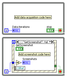

Hi Azazel,
I agree with DFGray that it's good to consider different image types for optimized performance.
I also want you to consider using an Event Structure to handle the part of the code that saves the screenshot. That is probably easier than using Queues for this purpose. Here's how you could do it:
I've attached the VI too (download LabVIEW 8.0 from ni.com/downloads).
Have fun!

Hi Azazel,
Well in that case you should just use a Case Structure instead of the Event Structure and then connect a boolean control to the case selector. Two things are important: You need to include a delay inside the loop so you don't take a screenshot a million times per second. Use the "Wait Until Next ms Multiple" function or the "Wait (ms)" function. The second thing to remember is to specify the correct mechanical action for the boolean control by right-clicking and selecting "Mechanical Action". For keeping the value repeated in the state the button is in, use one of the "Switch..." modes. The "Latch..." modes will only return the value once and then return the button to it's default state.
