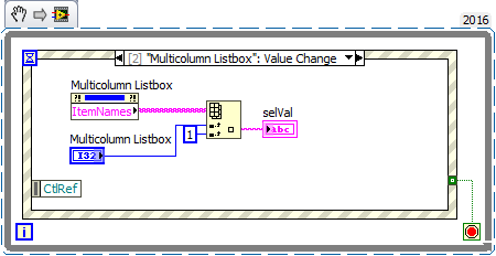

Use listbox:

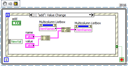

I done the block diagram but when i press save, it saved 2 times
(4,890 Views)

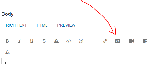

Use insert photos instead attach.
