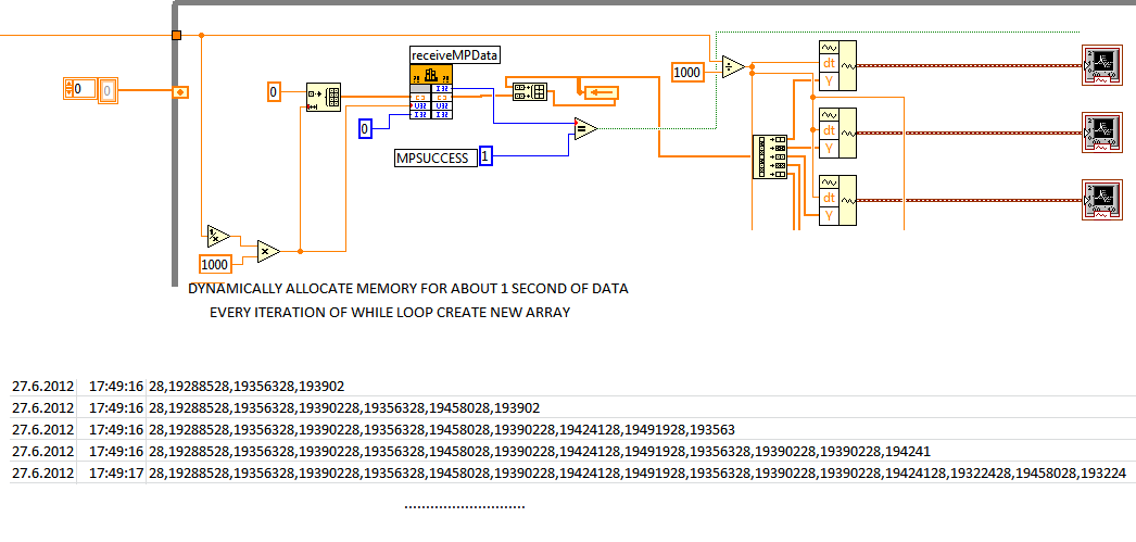

I'm acquiring data from one machine. I show all data from each channel on graph, which works OK, for different sample rate. What I want is to save this data to .TXT file.
Please take a look at my picture. What I need into .TXT file is value for each channel at each iteration. I tried to save  "value" Y from each "build waveform", but what I get is data on picture. It's always saving previous data(see picture at bottom), but I need just:
17:49:16 28,192885
17:49:16 28,193563
17:49:16
28,193902

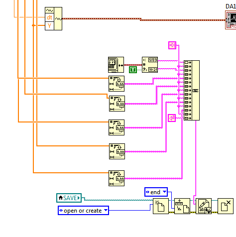

I'm saving like this (I know I must put "open and close" block outside of while loop, but this is not my problem right now). How can I index then to save just value of each itteration...

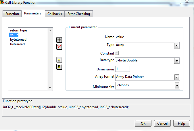

clfn (ReceiveMPData) return:
value(Y) which is output data for all channels:

So, I already answered your question it would appear. You could also wire the 1D array to Array to Spreadsheet and wire that to the write file with the timestamp.

Well I tried to add "index array" and add to "index" value "-1", but then it's saving all zeros to .txt file;
What I actually need is to get last element of array. With block "decimate 1D array" I just decimate array because channel samples are interleaved.
I hope someone actually understand what I want.
