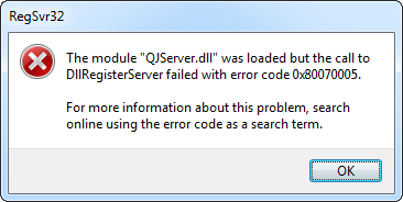

Hi Andrej,
Thank you for the attached code, I am getting the same error message:
Were you able to successfully connect to your ActiveX Server from any other programming environment, other than C++?
I suspect that the problem is in the .dll, for example the ActiveX automation server interface is incorrectly implemented, please refer to the article "ActiveX and LabVIEW" or  "Using ActiveX with LabVIEW" for the details and limitations.
The error message specifically mentions the ActiveX interface of your program.
Although not a requirement, I recommend that you implement the IDispatch interface type to be able to successfully use your ActiveX Server from LabVIEW. If you are using a custom interface, I recommend that you start your debugging there - As ActiveX is a 3rd party technology to us, I can recommend that you looking up Microsoft's referece and looking into creating ActiveX automation servers.
Please let me know if you have any further questions.
Best Regards,
T Simon
Applications Engineer
Certified LabVIEW Developer - Certified TestStand Architect
(4,545 Views)
Sorry, wrong screenshot:
