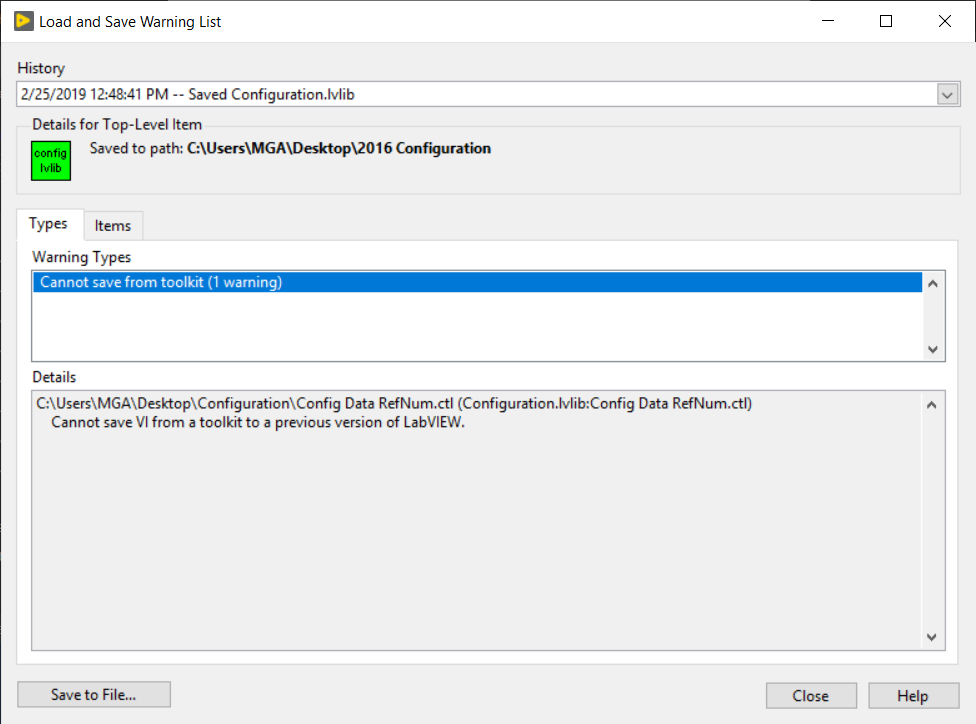

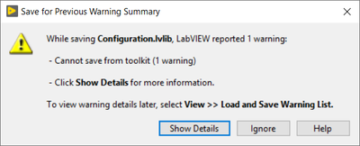

The attached ZIP file is a copy of the config.lvlib project saved in LV 2018 format that I have changed the library name and fixed all the file references (tricky in itself). I have a similar copy of the library that I have made changes to. I want to save this library to a previous version of LabVIEW.
When I try doing the save for previous version process from the library window, however, I get the following error.

Hi Jonathan,
Why is this error happening
That is mentioned in your error message: you cannot downconvert toolkit VIs…
and what is the best work around?
Install the same toolkit (from its official source) in your other LabVIEW version…
