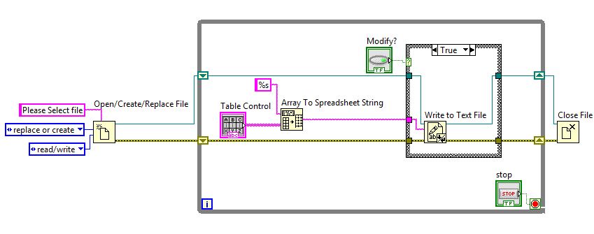

I'll just give some examples on how to write to excel file. As shown below is an example of how I can store the file the text file:
First I prompt the user for the file. If it is not found, I'll create a new file. Then I convert the data from the data from string array to spreadsheet string. So I can choose to save the data from the table to the text file by pressing modify. Once you are done data logging, you can drag the .txt file on the excel worksheet and it should be showing the data in spreadsheet just like how you would see from the table. (I have also tested on creating a .xls first before writing to it using Write to Text file and it worked)

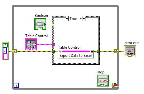

Alternatively, you can use Invoke Node to save a particular value in the table or you can highlight everything from the table to save into an excel file. when I press the boolean control after highlighting the values in the table at the front panel, it should export the data the temperory excel file which you need to save later.
