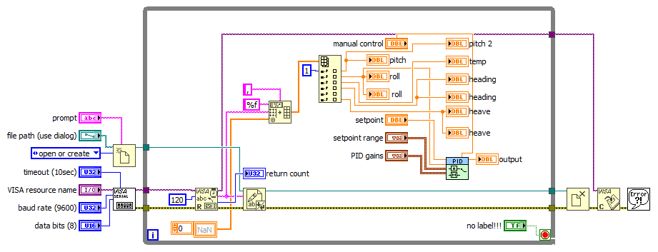

Sorry for late reply.
pl see the VI attached.
Also, pl tell me whether to use RT-FIFO for saving the RT data from cRIO to host PC?
Message 5 of 18
(6,704 Views)
Hi nehap,
No, the RT-FIFO only works "inside" the RT!
As has been suggested before: use network streams (or other network communication schemes)!
- you can resize the IndexArray node so you only need one of them
- what's the point of putting the PID inside this TimedWhileLoop?
- why did you delete the label of the stop button? NEVER do that again!
- as you didn't set any default values you still don't say the file path you are trying to save your data to…
- there is no error handling at the FileOpen function!
- do you think you can go the those default PID gain values?
Message 6 of 18
(6,696 Views)
Thank you for the reply.
 I wanted a continuos data in the output, so i thought of putting PID in the same loop as that of the data input. Is it a wrong way to use it?
I didnt get this point, can u pl ellaborate?
I was trying to manually tune the gain values which I obtained from a simulation in simulink.

i think GerdW did not show you the correct version, only a cleaned up and simplified version of your code,
which is appreciated if you ask for input to clean up your vi.  (EDIT: but you could do it that way too, depends on time criticality)
the default values are values you put into your controls and then Edit->Save Current Values As Default,
which lets ppl see what your input values are (like the path for example)
use a network stream to transfer data from crio to pc and another network stream to transfer data from pc to crio.
use either a state machine or a producer-consumer design pattern.
