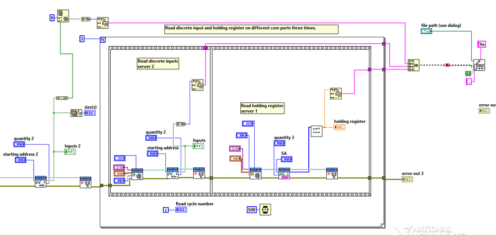

I have tried the option of putting all data reads in arrays then writing all to file but it doesnt look good and for some reason the link between the concatenate strings and write to spreadsheet file functions doesnt work. I know that the source is string and sink is 1D array of strings but I have seen a youtube where this worked. Any solutions?

If you want to build an array it might be a good idea to use the Build Array Function not the Conncatenate Strings functions.
BTW, the flat sequence can be omitted - Dataflow already does the job.
The For Loop also is useless as you request the same values 3 times, but only use the last value.

If anyone else is searching, I have found a solution to write multiple reads on one line. I found that the build aray function will concatenate, which can be altered in the shortcut menu by selecting "concatenate inputs". I also used part of a 2D Boolean to string.vi which I found on a post by P@Anand, to write booleans to an array with a for loop. So I changed the tunnel in my for loop to do the same with the three consecutive reads - which you pointed out would only give a final value. Some of the inputs had to be treated differently to get them all on one line.
