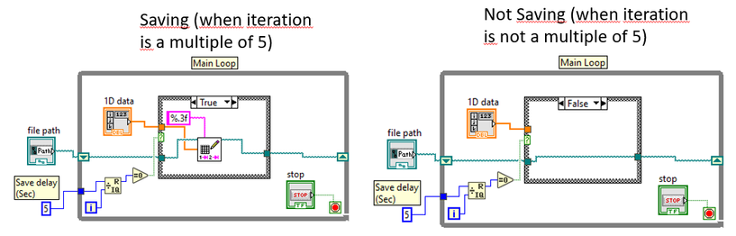

My problem is quite simple, and my solution should be working according to the documentation. I have a program that runs indefinitely within a loop. Using the iteration counter and the Reminder and Quotient function, I can set a delay on my save so that I don't save data at every loop iteration. To do so, I check whether the remainder is =0 to either save or bypass the save for the current iteration. The problem is that, even though I use a shift register to keep track of the file path and ensured that ''Append to file?'' was set to true, the save stops after the second save iteration. No pop-up windows asking for a new file path or any error occurs: the data just stops saving. Is there any additional steps that are required to re-open a file once the write delimited file function has been skipped once? The image below shows an example of my program loop.

  • Your blue inputs are swapped. the iteration terminal should go on top and 5 at the bottom.
  • It is pointless to place the path into a shift register because it is loop invariant.
  • You can wire the remainder directly to the case structure and make one case 0 and one the default.
  • Currently, you get a save on the first iteration. If you want to change it so the first save is after five iterations, add a "+1" after the iteration terminal.
  • You should define a loop rate. currently is spins as fast as the computer allows.
  • How do you get new 1D data?
  • It would be more efficient to use lowlevel file IO, open the file before the loop, close after the loop, and append a row whenever needed inside the loop. The highlevel file write you are using is opening and closing the file with each call, which is much more overhead.
  • etc.

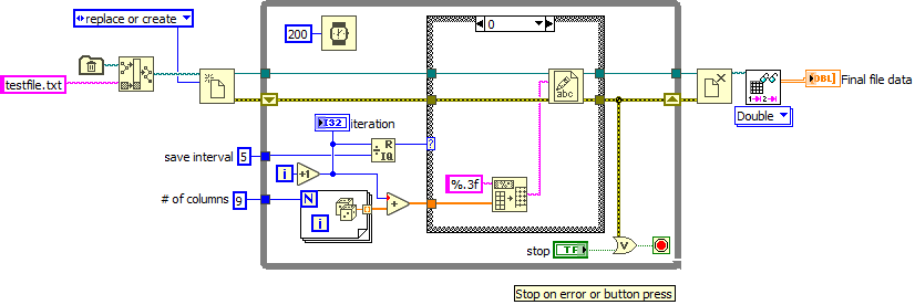

see if this can give you some ideas:

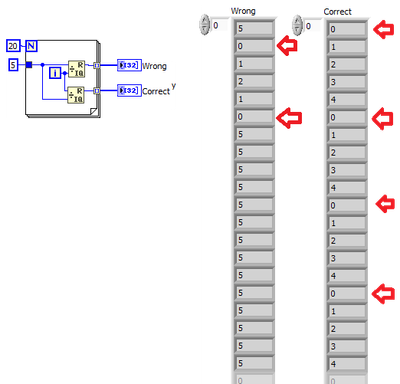

As I said, the problem is that the inputs to the Q&R are reversed, so the remainder is only zero exactly twice.
Once the inputs are swapped, you get regularity. 😄
