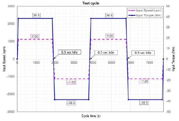

I have a specific requirement on a ATE. This is meant for HALT of a gear box and runs non stop for days on end to complete each schedule. A typical test pattern is as below.
Normally on  ATEs we only save waveforms in specified intervals, like if the test is for 1 million cycles we save the wave form once in 10K cycles. Of course the critical paramaters of the cycles are always monitored and rig stopped when they go out of bound.
But in this case client wants to save all the waveform data. Since each cycle is about 4000ms, it takes about 160 points when running with a scan time of 25mS. Even 1000 cycles mean 160 thousand data points.  Right now we are using CSV as the file saving format.
