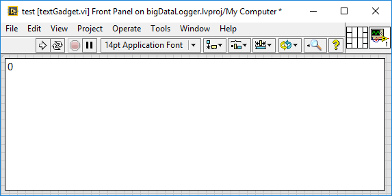

I have a VI with a numeric control only in the fron panel. I'd like the control to be scaled with the window (even the font). In other words, when windows is resized, the numeric text should fit the window.
I've enabled the option "Scale object with pane" but when the windows is resized. only the numeric box is resized; text font doesn't change.
Is there a way to fit font to the control box?

One Possible Solution is:You can get the Button size and based on that calclalate the Text Box Size (Use Property Nodes)

 Find the attached VI(Scale numeric control with pane (even the font)). That approach will hel for you.. but  you need to  change  Numaric data type  to text data type

This  is will  helps you.. please check it...

Thanks veerababu. I've used your example as base for my solution and it works fine (see attachment).
