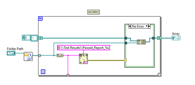

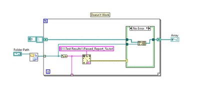

Hey NI Crew,
Here's a simple one for ya. I'm trying to use the Scan From String to dig through a bunch of data files to find the appropriate files.  I can do it to a certain point.  I'm looking for files that are identified as Passed but also have the .txt extension.  The .txt extension is causing this to not work.  I remove it, and I get all the passed files, but every different type of extension.  What's the magic trick here?  Using LabVIEW 2009, fyi.  So don't send me any VIs beyond that please.
DailyDose_0-1634225309767.pngDailyDose_0-1634225309767.pngDailyDose_1-1634225345186.pngDailyDose_1-1634225345186.png

Apply the file extension to the "pattern" input on the "recursive file list" block.
Have fun.
0xDEAD
edited to add: In your case "pattern" would be *.txt

If the standard wildcards work then a pattern like ?Passed.txt might work better

Hmmm... I mean sure if you wanted to do it the easy way. LOL
Thank you.
(2,547 Views)
If you wanted to keep with the Scan From String, you need to use "%[^.]" instead of "%s".  The bracket notation looks for specific characters and the ^ states not the next character.  To this will take all characters up to the period.  The normal %s looks for a white space to stop the scan.
But the super easy method is to use the Recursive File List.vi and use "Passed_Report_*.txt" as your pattern.
