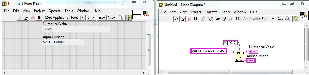

Please  go through the thread linked below
http://forums.ni.com/t5/LabVIEW/scan-from-string-error-85/m-p/3285591
if still facing any problem

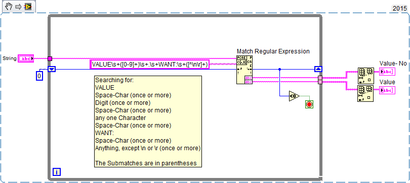

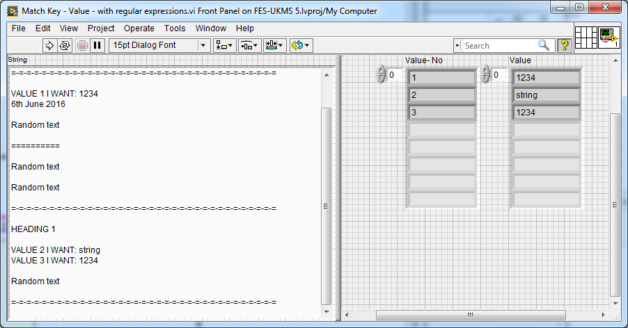

This is quite a universal approach:
Greets, Dave
