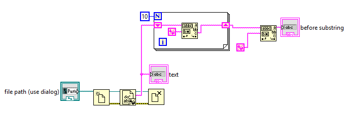

This image shows a really slow way of finding the offset of the target line by reading all the file line by line (wich is what I dont want to end up having to do).

But I guess your second suggestion is probably going to work perfectly.
Soomething like this could allow me to search the file for specific lines much faster.
1. Reading the file as a big string.
2. Skyp 10 lines by searching for end of line.
3. Get next line.
Ill try like this a post the results I get whem im done.

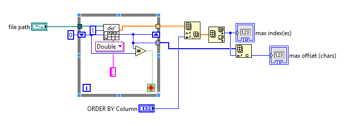

I have made an algorithm to search for the max value of a file.
The idea is to quickly find the max value of a certain column of the file, by reading the file as a string, and performing a binary search. Therfore the file must be sorted (or semi sorted, as I explained before, I have a circular buffer overwriting old data with new data, and the max position in the file could be in any row but the file is sorted before, and after this row). I have added terminals to specify the delimiter used in the rows, and to specify wich column is the one the file is sorted by. I have not added a terminal for the end of line delimiter, it's set as line feed string constant as that works for mee.
I would very much apreciate suggestion and improvements on this topic!.
Ty for your suggestion:
"Other option: read the file as pure text and parse on your own (avoiding conversion to big 2D array). 500k lines by ~80bytes/line is just 40000kByte=40MByte, any modern PC should handle this - as long as you avoid additional buffer allocations!"
I think this will perfectly fit in what I need to do (wich is monotiring a program wich is writing this CSV circular buffer files for the new added data).
PD: This is not 100% debuged xD migth fail in some cases I haven tested enough.

Edit 1: Missing shift register on the max value in the while loop.
