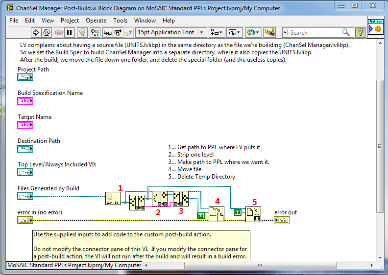

SO, to work around this silliness, I changed the Build Spec to put the PPL I'm building into a folder all its own, and made a POST BUILD VI which moves it where I want it, and deletes the folder and associated detritus.
Still, I don't understand why this is necessary.

CoastalMaineBird wrote:
I understand that it uses the UNITS PPL as a source file, but what is the problem with having a source file in the same folder as a dest file?
While I haven't run into this situation specifically, I believe this is in place to prevent you from accidentally overwriting a source file with a file with the same name in the build. For example, let's say you have a VI set to always include in your build specification (because you want to call it dynamically) and you set the location for it in the build to match the source location, and you also have the remove block diagram build option set (this is the default). Would you want your source code overwritten by the compiled version? It's easier for LabVIEW to enforce a rule that the build directory be separate from the source, than to try to figure out for which file types it would be safe for source and build to mix. Build systems in other languages likewise encourage a separate build directory, although I don't know how many enforce it.
Of course not, but when the destination has a completely different name from the target, that's not even remotely possible.
I suppose that the AppBuilder thinking is this:
1... I'm building ChanSel Manager.lvlibp from ChanSel Manager.lvlib.
2... That ChanSel Manager.lvlib needs something in UNITS.lvlibp.
3... Because of #2, I need to COPY the UNITS.lvlibp from where it is to my  build destination.
4... Because of #3, I'm trying to COPY a file from where it is to where it is.
Rather than recognize that it's already there, it complains.
