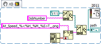

I have put code into my app for screen dump of the front panel.  Problem is, sometimes it works, sometimes it doesn't work.  The Path indicates correction on the front panel, but checking the destination finds nothing.  Here is my code.  Also, Y directory is on a remote server that i make sure is communicating before I attempt to save a screen.

Hi Cory,
- building a path using ConcatString is always dangerous. Use BuildPath instead!
- to correctly format a timestamp I prefer FormatIntoString (or FormatDateTimeString)! No need to search&replace some chars!
- why do you create a BMP? Why not use PNG instead?
- it would help to attach a snippet instead of a plain image. It would help to autocleanup before uploading…
- there is no error handling in your image: do you get any errors at the BMP file function?
Like this:

I can't find the vi that you are using to tie the 'Get Time and Data' vi ' to.  You are using it to append the job number, file name etc to the Path build.  I can't find it.

Hi Cory,
I named it in my message: FormatIntoString…
Btw. I embedded a snippet in my last message. You should look up those "snippets" in the LabVIEW help!

I coded the screen dump exactly as yours with the exception of not finding that one vi, so I used the format time vi and that worked fine.  The problem is that it is usually the very first time I try to save a screen it doesn't work, but then it works every time after that.  Any reason for this?  Also, the was my original save was coded, works for all of my data saves since 2005.  It's the screen dump that has always given me issues.  I will see if it has something to do with saving to the remote server.  I'll set up a folder on my local machine and try that.

Hi Cory,
Is that network drive set to "bind late"? That would explain problems with first save attempt as the drive needs to be "initialized" by the OS, which may take too long!
But then you should get an error message from WriteBMP - but you failed to implement error handling…
I named that function twice: FormatIntoString (for the 3rd time)…
Can't you use that snippet?

OK.  I used the tip and successfully downloaded the snippet.  I also had the correct subvi.  I didn't realize the input connection changed to a small hour glass the second you connect the 'GetTime' subvi.  Now, what the heck do I do with the snippet?  I pasted it into my existing vi, but there it sits.  Am I supposed to paste it into a new vi and then try it?  Anyway, I connected an error subvi to my code and learned I get an Error 7 the first time I try to save the screen.  I continued to get the same error with several save attempts.  Then, I went to the folder on the server to see if there was anything there.  There wasn't.  I went back to my app and BINGO!  The save worked!   So, it's like my app doesn't know that location exists until I go there in explorer and them come back to my app.  Why is that?
