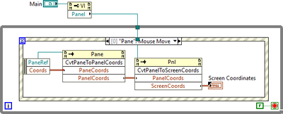

@lucian.grec wrote:
I don't have a problem with the references part. I have a problem with the math I have to do to get the coordinates right in the screen coordinates or at least the top level VI hosting the subpanels + control in one of them. I've attached an example to the initial post that works for 1 subpanel but not for multiple nested ones. Imo it should work, logic behind it being a coordinate system transformation from one to the other until you reach the end, and since it works for 1 transformation it should work recursively as well but it doesn't.
It depends a lot on which coordinates you get as an input.
Properties and events can return either control coordinates (picture control), pane coordinates (pane mouse move) or panel coordinates (panel mouse move).
You might need more math, to do the math for your exact situation.
The PanelToScreenCoords needs to be done with the top level VI, and then it should work PanelToScreenCoords should convert local pane\panel coords to screen:
This does require two things: 1) you need to know if the VI runs in a subpanel, 2) you need the reference of the top level subpanel's VI. That's where the idea exchange idea would help, you wouldn't need to propagate the VI ref of the main.
