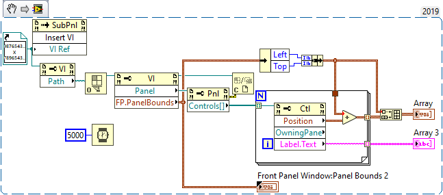

@Yamaeda wrote:
The Panel.bounds gives screen coordinates, so that + control position should give screen position regardless of subpanel level.
I think that this also needs correction for the pane origin?
I'm not sure if it will work with more then 1 pane.
This is all way too difficult...
Message 11 of 12
(345 Views)
wiebe@CARYA wrote:
Quick test showed that to be the case, yes. Moving the sub panel and saving it yielded the same result with the code above ...
