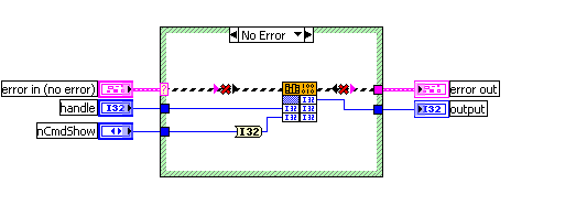

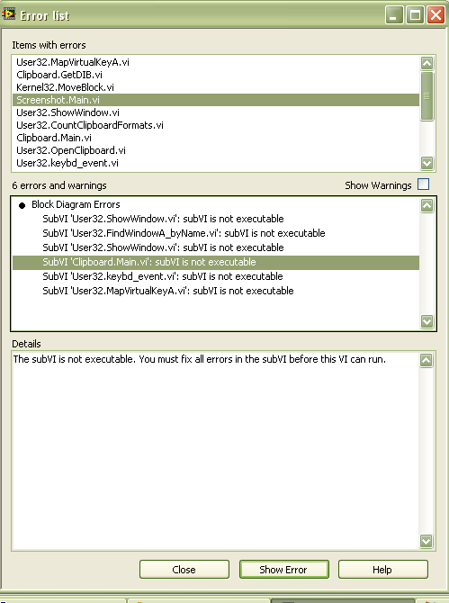

In all the subvis I get this error and when i try bypassing the error connection labVIEW crashes.
