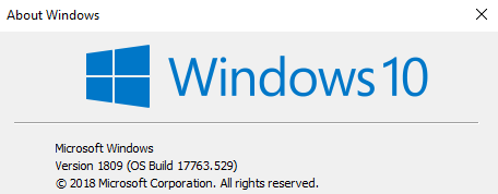

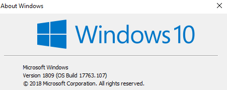

@_Bryan wrote:
@BoKnows wrote:
As I don't see this posted here, I wanted to point out Microsoft released updates recently.  The following list of fixes should correct the scripting behavior we're seeing.
Windows 10, version 1703: KB4480959
Windows 10, version 1709: KB4480967
Windows 10, version 1803: KB4480976
For Windows 7 there is an “Preview of Monthly Rollup” KB4480955 from January 17, 2019
I am running Win 10 version 1809 and it is still broken.  I tried 2017 and 2018.
It appears there's now a fix for 1809 with KB 4482887
Message 62 of 69
(3,849 Views)

Hi
I fixed this issue by updating windows 10.
My environment is windows 10 version 1809, details as below. LabVIEW 2015, 2017.
Then update windows to as below, the issue is fixed.
KB4497934
Message 68 of 69
