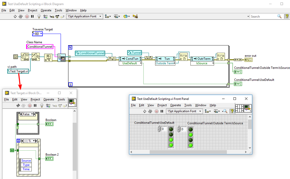

When I was testing this VI Analyzer test I noticed something strange on event structures.
The input tunnels for event structures and cases are also conditional tunnels. I understand that the output tunnels of these structures are conditional but don't see why the input tunnels are of the type conditional tunnel.
The problem however is that for event structures the property "UseDefault" is always TRUE. On output tunnels this property can be defined by the developer in the right-click menu "Use Default If Unwired". For input tunnels however this property can not be changed, even more it has no use since there is always a wire connected on the outer terminal to define the value. For case structures the property "UseDefault" is always FALSE for input tunnels, which is better.
The above mentioned VI Analyzer test gives incorrect warnings if a tunnel is unwired on the inside of an event structure.

Hello Stefan,
It would have been better if the UseDefault property was set to false in those cases where it is not applicable. An inapplicable true is just more confusing.
At first I fully agreed. I had already typed the bug report, when I started to ponder again and maybe found a god explanation:
Event Structure outputs are set to "Use Default If Unwired" by default. Case Structure outputs are not. Internally, input and output tunnels seem to be the same - if they are an input or output (source or sink) seems to be derived from what is connected to them.
This way it makes sense (at least to me Smiley LOL) that Event Structure inputs have UseDefault set to true - otherwise LabVIEW would not know which state to use when an output was converted to an input and back.
I adapted the VIs you posted to briefly check if the current tunnel is an input or output (I believe this is an approach similar to the one the VI tester you linked uses):
(Attached in LV18 and LV13)
Of course, LabVIEW IDE could implement hidden logic to (re-)set inputs to UseDefault=false, but I believe such hidden features would confuse more than the current unexpected but logic structure.
