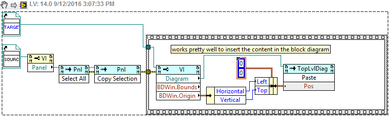

What I mean is that if I have VI references for A.vi and B.vi, I want to take the content of the front panel of A.vi (controls, comments, decoration etc.) and insert it in the front panel of B.vi.
My point about QuickDrop is that it has to be possible because you can create a shortcut to  do just that.
I know how to do it from the front panel of A.vi (source) to the block diagram of B.vi (target), see below (it is probably not the best thing to do but it is just to illustrate my point). However, I have not found how to do it from front panel to front panel.

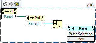

I found the method you were looking for... it is actually at the Pane level.  Hopefully, this is the missing piece you needed.
