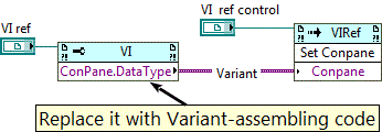

There is Invoke Node Set connector pane. It modifies control (VI ref type). The node works well for setting connector pane of existing VI to control; i.e. connector pane is read from VI (as Variant) and set to control.
Is there any way to assemble this Variant without involving any source VI?
May be there is a way for modifying this Variant?

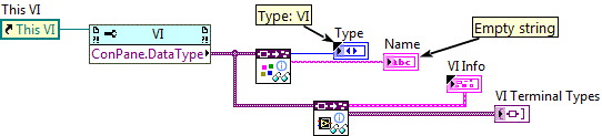

Yes, it could be anything. See:
The Variant type is VI. Get VI Information receives this Variant and returns all info about terminals.
I need something opposite; i.e. I need to "wrap" array of variants (VI Terminal Types) in Variant of VI type.
