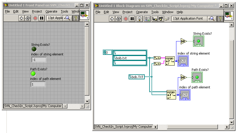

Hi, I was surprised by this result, but upon reflection I am wondering if the behavior of Search 1D Array when presented path data type inputs, is smart enough to know a Linux box is case sensitive, and windows machines are not?

It depends on the data type. when you take the path and compare it will take the .txt as an extension but the same when you do it with a string it takes everything as string so when you have different case you will not be able to match (Please correct me if I am wrong). Try to convert the string to upper case both and check its working.
