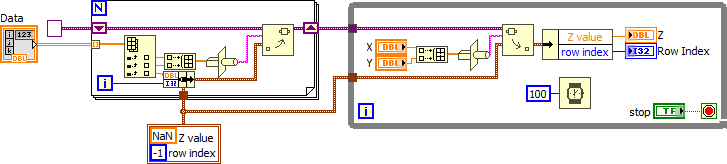

Here's what I had in mind (of course you probably want an event structure to avoid polling in the second loop. This is just a draft):

@altenbach wrote:
For performance, I would probably convert to variant attributes by casting the first two elements into a binary string to be used as name and having a cluster or flattened string of the the z and row index as value.
For an even more elegant solution, come to my 2019 NI Week presentation in May. 😄

@ryancam wrote:
In my real data set, I have x and y values that are not only integers.
Depending on where the data is coming from, equal comparison on floating point values can be very dangerous. You probably need to built some protection into it.
Also, if the xy coordinates are arranged in any kind of regular pattern (e.g. a scanned grid with x0, dx, y0, dy), more efficient solutions are possible. You could even do bilinear interpolation if there is no exact xy match.
