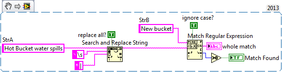

I have an application wherein I am trying to search StrA in StrB where StrA can be greater in length than StrB.
For Eg: StrA: Hot Bucket water spills.
StrB: New bucket
So I need to check if StrA any part is present in StrB. If the match is found then I will be doing further processing logic . I have checked with match pattern , regular expression, search/split functions , however not getting the expected output since StrA and StrB values can vary a lot. Also converting string to Array and then compare is not an option since these processing is only a initial part of application and needs much processing later.
I would like to implement a function which should be able to check if string one part is present in another string, then match should be found.

So you have StrA as a list of words you want to search for in StrB?  If that is correct, then use Spreadsheet String To Array with a space as the delimiter to create a 1D array of strings (words).  You can then use a FOR loop to perform the Match Pattern on each element.  Turn on the conditional terminal and you can stop the FOR loop as soon as a match is found.
Message 3 of 8
(5,392 Views)
Omar

Hi LV_user1
Do you mean like this?
Day@
Certified LabVIEW Associate Developer
Message 6 of 8
(5,334 Views)
@hidayatmaulud wrote:
Hi LV_user1
Seems extremely inefficient. For example if the two strings have very different word count, one will have many elements with empty strings. The middle code makes no sense because both array have the same number of elements guaranteed. The shift register in the second loop makes no sense because the content never changes.
Try to find a solution with 20% of the code. 🙂
Message 7 of 8
(5,327 Views)
