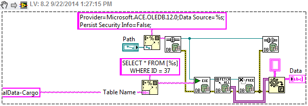

Do you know how to make an SQL query in LabVIEW?  It sounds like "SELECT * FROM [a table] WHERE [a field] = "a unique value" will get your row.  What have you got so far?

I like to use the Execute Query function:
Jim

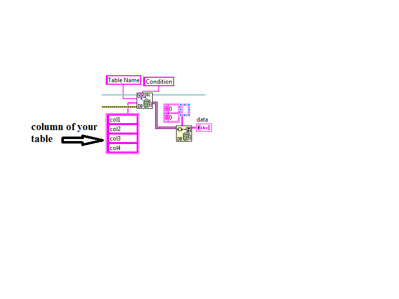

Instead use select. In the coulms input you can mention coumns name you need. Output will be 2D array. Change and manipulate as per your requirement
Kudos are always welcome if you got solution to some extent.
I need my difficulties because they are necessary to enjoy my success.
--Ranjeet
