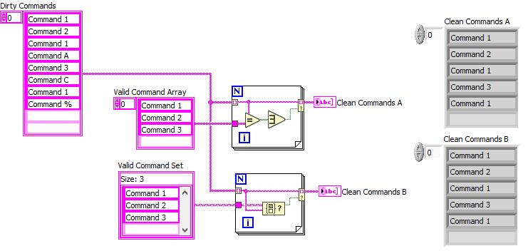

You can compare each with an array of valid commands or with a set of valid commands.
Here are two examples to clean the array of commands:
You could even do the "sending" right inside these loops and only send the valid command using a case structure.
