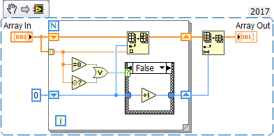

@Artybear wrote:
I had the same problem, wanting to remove 0s and NANs from an array. Eventually I succumbed to using a MathScript node
The use of Mathscript is no longer recommended and will probably cause a huge performance penalty in this case. For any graphical LabVIEW programmer, your code is incomprehensible and even mild dyslexia would interfere even more.
There is nothing complicated about my solution, which operates fully in-place and is trivially simple. It can easily be modified for any other condition and if you need this often, turn it into a subVI.
(note that e.g. delete from array should never be used in a tight loop)

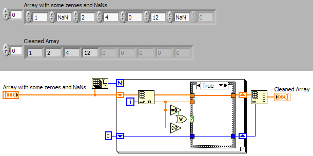

Ok.  I'll bite:
Message 19 of 23
(2,016 Views)
@paul_a_cardinale wrote:
Ok.  I'll bite:
Quite a bit more effort compared to my ancient example above, because if e.g. the array has 1M NaNs or zeroes, you do 1M replace operations while my code does zero for the same result.
(The change between index array and autoindexing is probably irrelevant. I have fewer tunnels at the cost of a size detection. I am sure the compiler can optimize both.)
