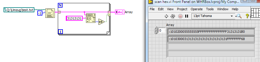

Hi Jessica,
using conditional tunnels the filtering part becomes quite easy:
(5,618 Views)
Thank you. That is working on numerous files. Where can I find more in-depth information on the conditional tunnels?
