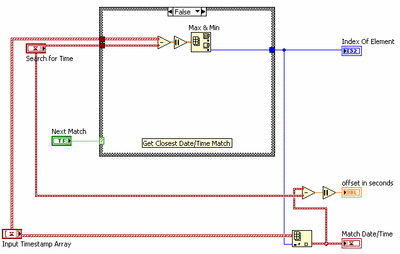

Thanks falkpl for your suggestion.  I was able to implement my brainstormed method except I decide to just use the next record instead of looking at the record before and after.  I incorporated both your method (closest record) and my method (next record) together in one vi and named it DateTimeMatch.  The vi will accept and array of timestamps and a match time and it outputs the closest/next match (dependent on the Boolean input, default is false for closest record) as well as the index for the match and the number of seconds offset.  See below:

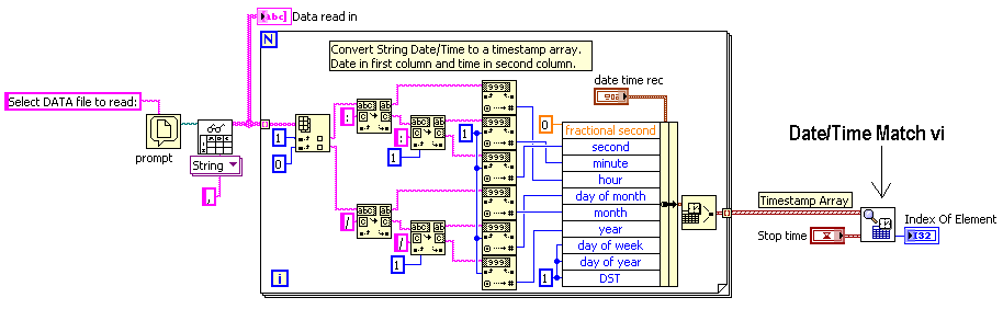

The hardest thing, which I thought was going to be the simplest, was converting the first two columns in the CSV file into an array of timestamps.  The way I did it is shown below.  Note in the image of how I incorporated the two Vis together.

Blawson,
I may have done it wrongSmiley Sad but I did look into using a variety of different string functions to format the string into a pattern to be acceptable and converted to a TimeStamp.  The only function that I could find that definetly would convert directly to a timestamp, was the "seconds to timestamp" function.  But to use it one would have to do some math on the string to convert the date and then the time to a total number for seconds since January 01, 1904.  It seemed easier to just use the bundle by name and convert to timestamp.
To clarify the first column in the CSV has the date in the format mm/dd/yyyy and the second column in the CSV has the time in the format hh:mm:ss.  I converted these two coulmns into one string and based on the month, day, year, hour, etc. sent the value to the bundle by name function and finally converted that bundle to a timestamp.  This method worked I was just suprised I had to do it that way.

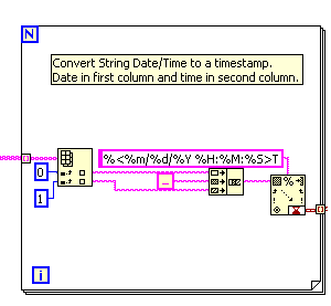

GerdW,
Oh I see this way you do not even need the "Decimal String to Number", "Bundle By Name" nor the "Date/Time to Seconds".  the one function "Scan from String" replaces all three.  I added a "Concatenate Strings" to create one string and then used your suggestion.
19999iAB8C5ECC06359C97
THANKS!!!!Smiley Very Happy
